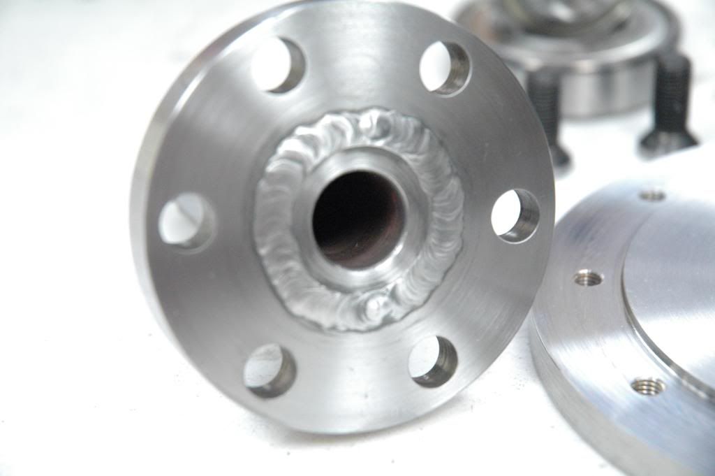

R1 output shaft coupler.
When I welded the sprocket to the coupler the splines shrunk and the sprocket would not fit the R1 output shaft. I machined the splines away and machined a counterbore for the second sprocket to center in and bolted two together to complete the coupler.
24 tooth sprocket welded to flange welded to splined shaft out of '04 R1 gearbox. This shaft will be shortened on both ends.
The coupler will be welded on this end.

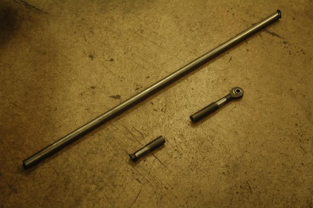

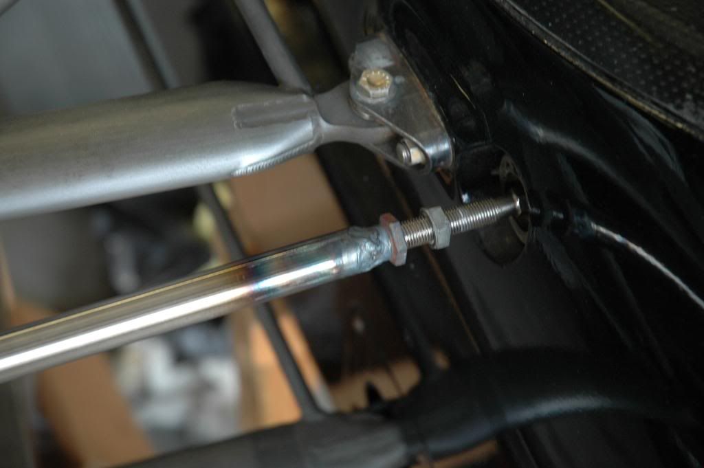

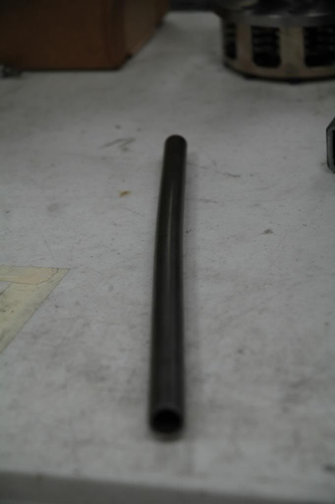

The right side tie-rod was bent so I set to work making a replacement.
After I cut the ends off.

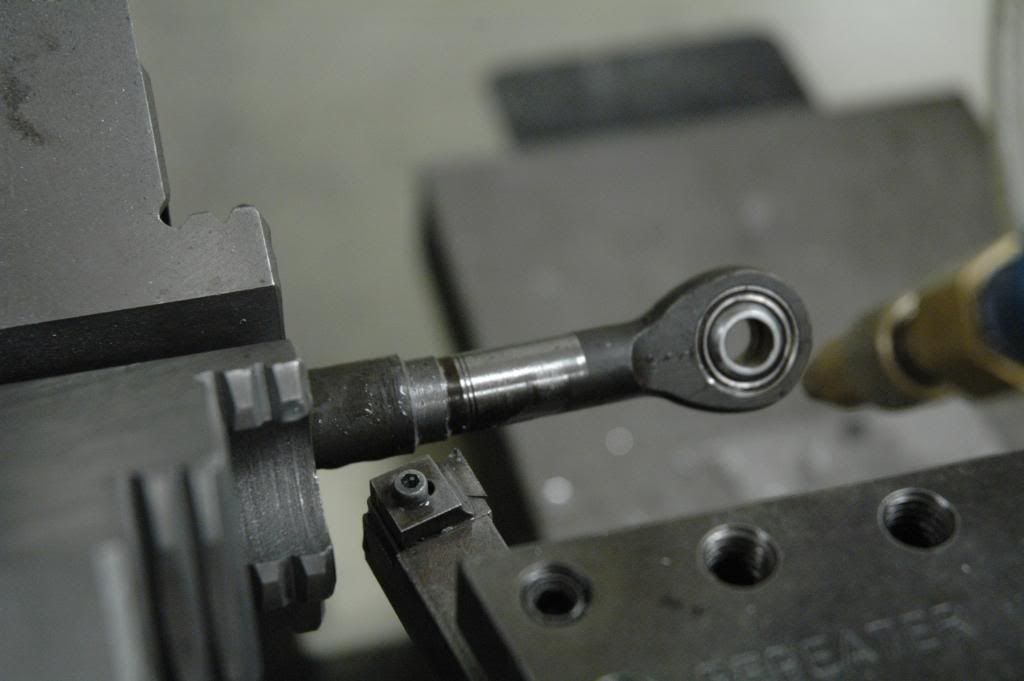

I was unable to locate replacement ends for the tie-rod so I machined the old parts away from the tubing.
New tie-rod.
